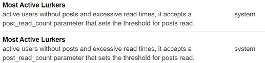

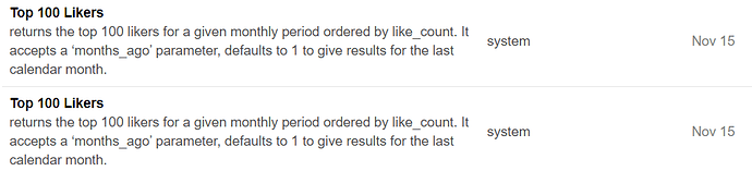

You might consider (exporting and) deleting all data explorer queries and removing the data explorer plugin prior to creating your backup.
Alternatively, can you post the relevant content of the plugin_store_rows table?
There are indeed duplicate queries with duplicate (plugin_name, key) pairs, e.g. q:-11 and q:-2, but unique ids. I don’t see any pattern among the duplicates, like they’re not my favorite queries or anything.
So my next step will be to remove the duplicates, make a backup, and try to restore from that.

Actually how can I delete the duplicates? All three are owned by “system”, so I can’t edit/delete them.
Found the pattern. When I run a query owned by system, it creates a duplicate, which evidently breaks restore.
I can’t reproduce this on a clean test site, but it happens consistently on my production site. I’ve installed all the production plugins on the test site, still can’t repro.
  1. How can I track down what’s wrong with my production site?
  2. How can I remove the duplicate queries, since they are owned by system? Do I have to sudo -u postgres psql discourse…? Sounds scary.
