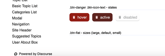

examples are missing (like the btn-flat)
missing btns like .btn-quaternary, .btn-tertiary, and btn-secondary

(& I see david has addressed the missing button examples.)

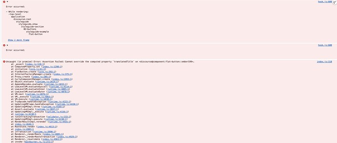

Interesting, when you navigate to your btn styleguide are you able to switch to a different styleguide page by clicking the sidebar WITHOUT refreshing the page? I am completely locked in on local dev and in production.
