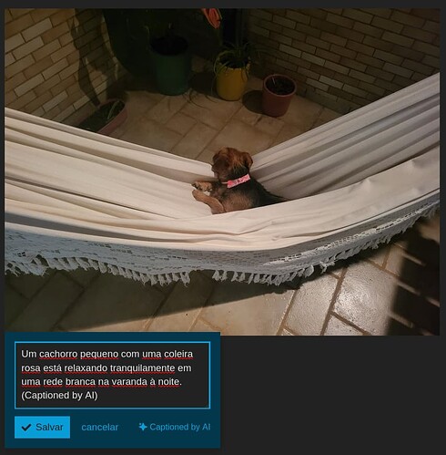

AI Image Caption
I extended it to image caption, and it’s working very well there:
