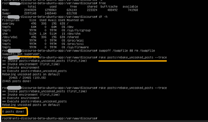

What you get from
free
df -h
The install script has detected you have less than 2G of RAM and less than 2G of swap, and is trying to create a swapfile. According to the source , it doesn’t deal with the case where there is an existing swapfile. Probably you should remove the existing swapfile and try again. This might be enough:
swapoff /swapfile && rm /swapfile
free
and got this error…
swapoff: Not superuser
I’m on a Digital Ocean Droplet, so I guess I don’t have the necessary permissions for that?
Hitting those blocks, I tried instead to just rebake uncooked posts running…
rake posts:rebake_uncooked_posts
It will run several hundred, maybe a few thousand if I’m lucky, then kills off again. After babysitting it since yesterday, I’m half baked.
Is there a way to run a rebake command that is throttled? I don’t care if it takes a while, overnight or whatever, I just want it to stop failing.

Oddly enough I let the uncooked run again while I was writing all of that up. Left for a long lunch with some friends and came back to it being 100% done. I’m not sure if the swapfile finally started working or if it was just a low use coincidence of timing, but…
done, finally!

Thanks. Not sure if I did it right or not.
That doesn’t look right. Which instructions are you following?
And why are you creating swap inside the container? Swap is meant to be created on the host not inside the container.

6
Because I only marginally know what I’m doing.
So that’s at the ubuntu: base level and not the ubuntu:/var/discourse or ubuntu-app:/var/www/discourselevels?
Any ideas on the rebake throttling?

Warning : don’t do things blindly on a production site, there is a strong chance of things going wrong without any real way to recover them.
no, it’s not the ubuntu: level.
Did you do a ./launcher enter app before trying to create swap? If yes, that what you shouldn’t have done.
When you first log on to your server is the host, when you enter app, you’re performing actions inside the container.
the swap needs to be created on the host, the application lives inside the container, this is what you will access to run the rebake command.

This means that you already have a swapfile, it’s called /swapfile, and it’s in use.
If you want to make it bigger, you can stop your container, then unmount it, and then use that dd command to make it bigger, and then the mkswap command.
If someone else reads this, the way that I do it is to grep swap discourse-setup and look at the commands there. It’s a slightly easier version of what to do.

I don’t know about you, but I was repeatedly going out of memory during a long rebake process. Creating a 2 GB swap improved (more posts got rebaked), but still OOM after a while. Increased swap to 4 GB, and was able to rebake all my posts.
I increased the swap size from 2 to 4 GB, and the rebake worked.
So, I guess it was about memory, though I am a bit surprised by how much it asks (8 GB RAM + 4 GB swap), especially since older rebakes didn’t have any issues with no swap and the same amount of RAM.
