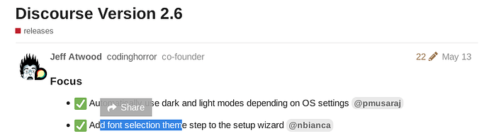

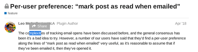

I have experienced another quoting problem, but this time on Meta as well as on the Fairphone forum, at 100% reproducible. I can’t quote closed topics, or more generally topics in which I am not allowed to post (such as posts in the releases category on Meta), in a post I am writing on another open topic. Only the Share button appears. I recall being able to do this before. I have tried on another Discourse instance running an earlier version, and it works fine there.
E.g
Or is it perhaps intended?
I don’t know whether this should go in a new topic or whether we should make this one a general quoting issues topic. Feel free to move it.
