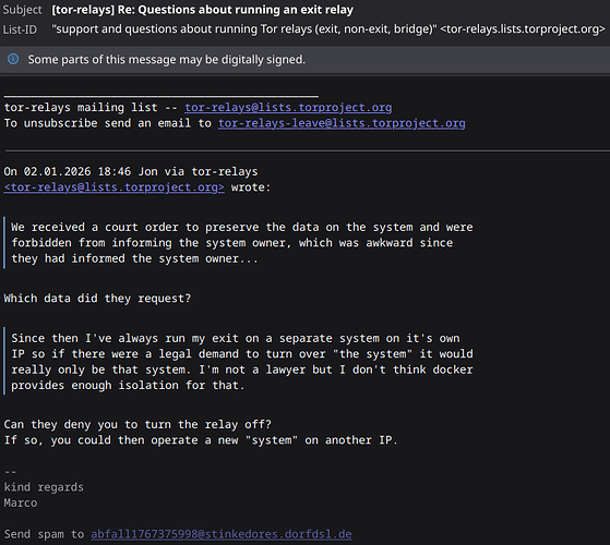

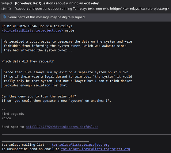

Let’s focus on this message sent to the mailing list topic.
The rejected post log incident headers show this:
Message-ID: <20260103080033.5f6d8f90@dorfdsl.de>
Date: Sat, 03 Jan 2026 08:00:33 +0100
From: Marco Moock via tor-relays <tor-relays@lists.torproject.org>
To: tor-relays@lists.torproject.org
Subject: [tor-relays] Re: Questions about running an exit relay
The full rejection reason text is this:
We're sorry, but your email message to ["tor-relays@lists.torproject.org"] (titled [tor-relays] Re: Questions about running an exit relay) didn't work.
Reason:
Something has gone wrong. Perhaps this topic was closed or deleted while you were looking at it?
If you can correct the problem, please try again.

As for the raw/cooked contents, only the raw property contains the full email with headers. The cooked property doesn’t exist in the object.
Running that through Email::Receiver.new(rawmessage).select_body returns:
=> ["", "", 2]
so I’m pretty confident what’s happening here is that Discourse is incorrectly selecting an empty plain/text portion as the message body, probably this one:
--Sig_/gizYC_1dGsAzUHvksdaMIe2
Content-Type: text/plain;
 charset=UTF-8
Content-Transfer-Encoding: 7bit
which would be an invalid post.
We’ll need to do a bit of investigation on this and probably use it as a test case.
The mail has the structure:
* #<Mail::Part:39500, Multipart: false, Headers: <MIME-Version: 1.0>, <Content-Type: text/plain; charset=us-ascii>, <Content-Transfer-Encoding: 7bit>, <Content-Disposition: inline>, <Content-ID: <6958bf289b75c_b28a46298091029@forum-01-app.mail>>>
  "___…tor-relays mailing list…"
* #<Mail::Part:39520, Multipart: true, Headers: <Content-Type: multipart/signed; boundary="Sig_/gizYC_1dGsAzUHvksdaMIe2"; micalg=pgp-sha256; protocol="application/pgp-signature">, <Content-Transfer-Encoding: 7bit>>
  * #<Mail::Part:39540, Multipart: false, Headers: <Content-Type: text/plain; charset=US-ASCII>, <Content-Transfer-Encoding: quoted-printable>>,

(yes, there’s three copies of the actual content, blank content, and the PGP signature)
That first text/plain part is added by the mailing list software and looks like this:
_______________________________________________
tor-relays mailing list -- tor-relays@lists.torproject.org
To unsubscribe send an email to tor-relays-leave@lists.torproject.org
that’s what Discourse (really, the mail gem via .text_part) is choosing as the content of the message:
> puts mail.text_part.to_s
MIME-Version: 1.0
 charset=us-ascii
and treated as a blank body with an elided signature.
Were it not for this mostly-blank part added by the mailing list, Discourse would have pulled out the following content for the post:

I can’t really find fault with Discourse’s mail handling here - if I were called to apportion blame I’d probably start with the mailing list software for effectively adding blank content at the start. That would be better suited at the end, after the real message.
It would have worked with the Mail gem and would also look better in mail clients - here it is in Thunderbird as originally received:
and my “fixed” version (test-fixed.eml.txt (14.3 KB))
with the mailing list signature at the bottom instead of the top:
If you want to see what would have been picked out for post content for a particular IncomingEmail, you can do the following to check:
Email::Receiver.new(IncomingEmail.find(INCOMING_EMAIL_ID).raw).select_body
