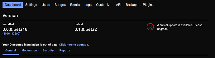

Update from 3.0.0.beta16 to 3.1.0.beta2
AI-generated summary
A user attempted to upgrade from Discourse 3.0.0.beta16 to 3.1.0.beta2 but encountered multiple issues, including a failed backup and a rake aborted! NoMethodError: undefined method 'path' for nil:NilClass error during the rebuild process. Initial attempts to upgrade via the GUI failed, and the rebuild via SSH also failed with a pups exec error during asset precompilation. The issue was traced to the DISCOURSE_MAXMIND_LICENSE_KEY in the app.yml file. Despite having a valid key, the rebuild failed. After commenting out the Maxmind key, the rebuild succeeded, and the system functioned normally, with backups and email notifications working correctly vmsman, vmsman, vmsman. The user confirmed that the invalid key was the root cause, and the community discussed the unexpected impact of the Maxmind configuration on the build process vmsman, Falco, pfaffman.
I tried to do a backup and the backup failed.

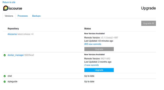

I tried to do an upgrade.
At first, the upgrade screen had everything disabled. I rebooted and then I was able to select the docker_manager upgrade. That failed with:
rake aborted!
NoMethodError: undefined method `path' for nil:NilClass
