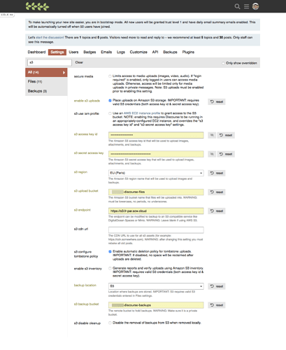

I’m trying to set up Discourse to use Scaleways S3-compatible Object Storage, but I can’t seem to get it to work and I’m not sure where the problem is.
I’ve verified that the both of the buckets work using aws-cli and that the CORS settings are properly set up by following the official docs from Scaleway so I don’t think the buckets themselves are the problem.
These are my Discourse S3 settings (part of bucket name redacted):
When I open the backups tab I get ‘Failed to list backups from S3: Aws::S3::Errors::BadRequest’
And when I try to upload an image, I see this in the log: 'Job exception: Failed to open TCP connection to [redacted]-discourse-files.s3.fr-par.amazonaws.com:443 (getaddrinfo: Name or service not known) '.
I’m running the latest Discourse - 2.4.0.beta10 (14ae574bc5).
