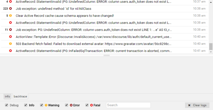

The Logster web UI
Every Discourse instance ships with a GUI log viewer. It is located at: https://=DOMAIN=/logs
Note: if you are on a hosted plan, this page may be hidden from you. Instead, contact support when you’re getting this kind of issue!
If you’re investigating a mysterious 500 error on the forums, you should always try this spot first!
Select an error line to get details about it. You may be asked to provide the contents of the env and backtrace tabs here on Meta.
