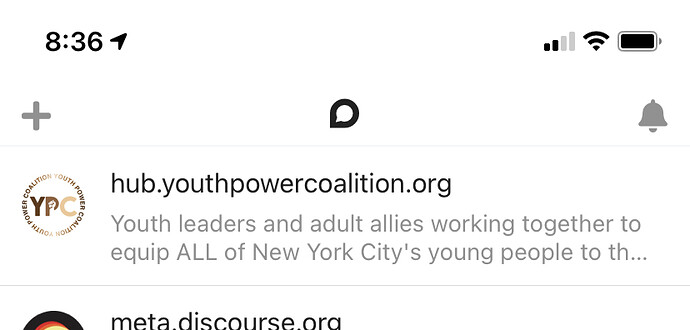

On the iPhone app, every Discourse forum I’m signed into has a description under the forum url.
Where do I change that description?

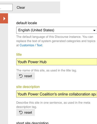

I assumed it was the site description setting but the words don’t match.

It’s either short site description
or short site description
. I think the Discourse app reads it once and won’t pick up on any changes unless you remove the site and add it again.
The iPhone app used the site description and I needed to remove then re-add my Discourse site to get the description updated. Thank you!
Are there plans to have the app periodically check if site descriptions have been updated instead of users needing to re-add the site? Not the biggest deal, but it was a mystery before this community helped me figure it out.
