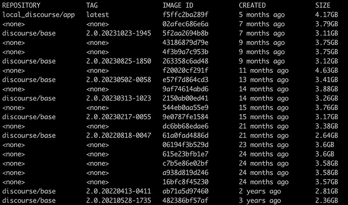

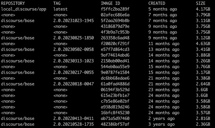

docker ps -a
docker images

From the screenshot under ‘docker images’ in the top post it seems there are a lot of older images, but don’t know how to target them specifically for deletion, and whether this would cause any troubles.

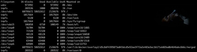

df
If the docker container is running, it won’t delete the container. If the container is not running, it’ll delete the container, but you can rebuild a new one with ./launcher rebuild app.
