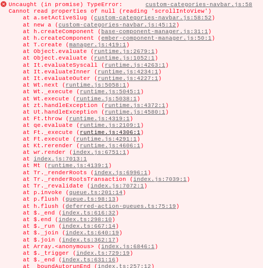

The sub-sub-categories appear as they are meant to throughout the site, but when I attempt to click onto one of them I notice this:
  1. The category page seems to load just fine initially
  2. Then I get the spinning wheel of doom :skull_and_crossbones:
This error appears in the console:
(this doesn’t appear when in categories or sub-categories)
Workaround / other issues
The sub-sub-category page actually loads okay if opened in a new tab/window, but there are glitches in the navbar functionality and this similar error in the console:

This is fixed by: FIX: update to support 3 levels of categories by awesomerobot · Pull Request #6 · discourse/discourse-categories-navbar · GitHub
I just needed to make a small adjustment to accommodate for the additional category level. Thanks for reporting it!
