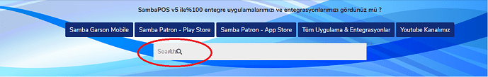

Hello community
I’ve been having an alignment problem with the search field with the latest updates. I thought it would be solved with the next updates, but for about 2 weeks now the search field has been looking like this. Any solution suggestions would be appreciated.

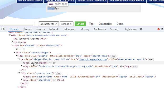

That’s odd . This is not what I see on your HTML:
Looking at the code, the translation is used in that <span>:
contents.push(
this.attach("link", {
href: this.fullSearchUrl({ expanded: true }),
contents: () => [
h(
"span",
I18n.t(themePrefix("search_banner.search_button_text"))
iconNode("search"),
className: "btn search-icon",
title: "search.open_advanced",
I think you defined this translation in English locale, but you currently use another language.
I can see it:
Yes, the language is Turkish, but I have been using it this way for 2 years and did not experience any problems. Where could I have gone wrong ?
