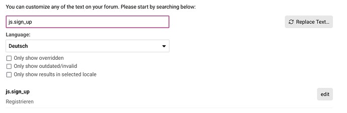

What happens if you search for js.sign_up instead of “sign up”?

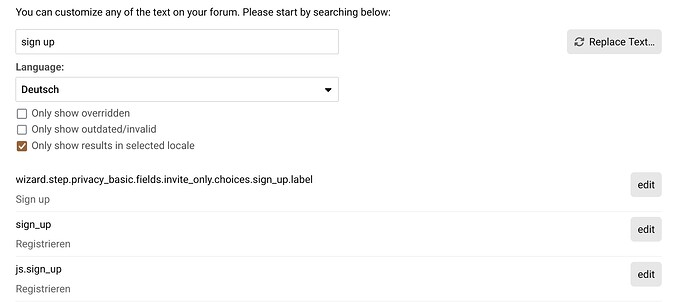

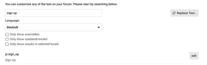

I selected German and even without an overwritten translation, I see “Sign up” as long as I don’t search with the name of the string.
The “only show results in selected locale” checkbox seems to help:
3 לייקים
That does not exist on 3.3 stable :thinking:
2 לייקים
@hugh can you add this to your list? I was able to replicate the problem as stated by RGJ in the OP and also the different behavior as stated in Moin’s reply.
tl;dr the UI behaves differently when searching for “Sign up” (content of the text field) vs “js.sign_up” (name of the text field), then changing the content of the field, then going back to the search.
  • expected and correct: /admin/customize/site_texts?locale=en&q=js.sign_up
  • unexpected and broken: /admin/customize/site_texts?locale=en&q=sign%20up
