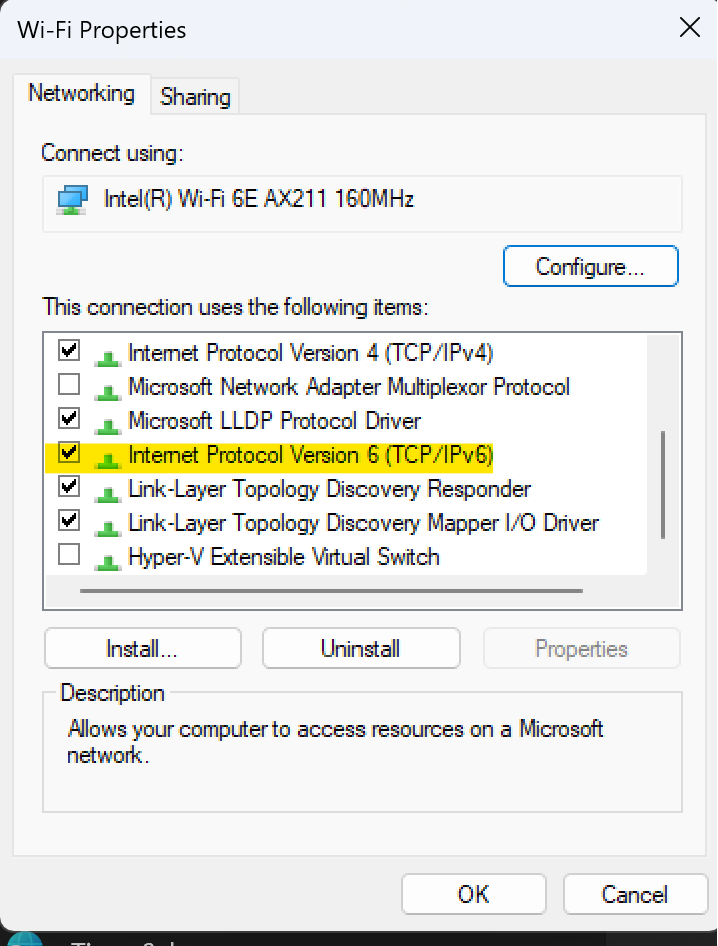

  • I tried disabling IPv6 from Windows settings:
Which, as per my understanding should make connections only from IPv4. If yes, that worked.

  • Not sure how I can test only IPv6 because as soon as I disable IPv4 similar to IPv6 from the above screenshot (while leaving IPv6 on), my PC basically got disconnected from the internet - all connections failed which could be expected.
