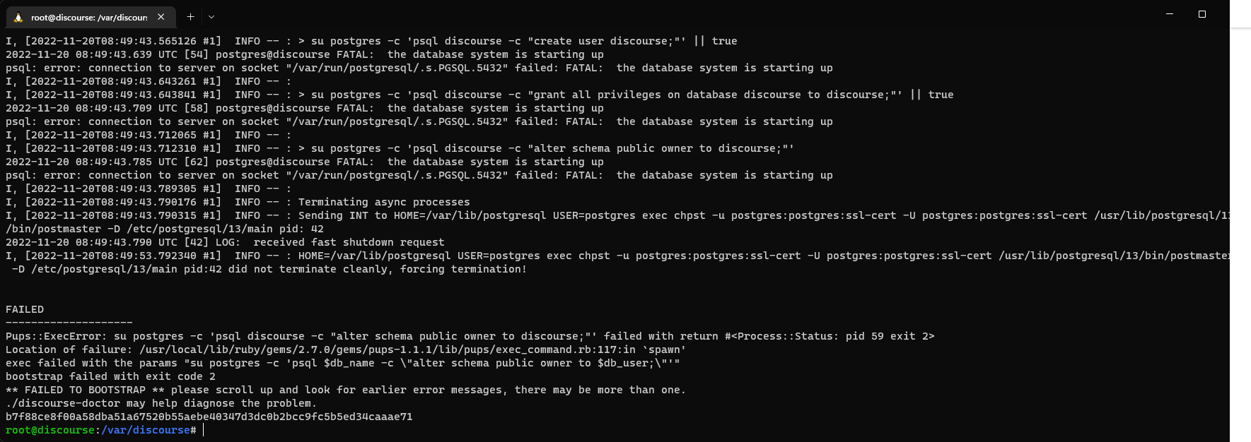

This is the error I am getting:

2022-11-20 08:15:19.593 UTC [42] LOG:  starting PostgreSQL 13.8 (Debian 13.8-1.pgdg110+1) on x86_64-pc-linux-gnu, compiled by gcc (Debian 10.2.1-6) 10.2.1 20210110, 64-bit
2022-11-20 08:15:19.593 UTC [42] LOG:  listening on IPv4 address "0.0.0.0", port 5432
2022-11-20 08:15:19.593 UTC [42] LOG:  listening on IPv6 address "::", port 5432
2022-11-20 08:15:19.619 UTC [42] LOG:  listening on Unix socket "/var/run/postgresql/.s.PGSQL.5432"
2022-11-20 08:15:19.653 UTC [45] LOG:  database system shutdown was interrupted; last known up at 2022-11-20 08:13:26 UTC
2022-11-20 08:15:19.961 UTC [45] LOG:  database system was not properly shut down; automatic recovery in progress
2022-11-20 08:15:19.976 UTC [45] LOG:  redo starts at 20E/B7706EE0
2022-11-20 08:15:21.251 UTC [45] LOG:  successfully skipped missing contrecord at 20E/C95C8360, overwritten at 2022-11-20 07:39:48.040705+00
2022-11-20 08:15:21.251 UTC [45] CONTEXT:  WAL redo at 20E/C95CA018 for XLOG/OVERWRITE_CONTRECORD: lsn 20E/C95C8360; time 2022-11-20 07:39:48.040705+00
2022-11-20 08:15:21.251 UTC [45] LOG:  invalid record length at 20E/C95CA048: wanted 24, got 0
2022-11-20 08:15:21.251 UTC [45] LOG:  redo done at 20E/C95CA018
I, [2022-11-20T08:15:24.460654 #1]  INFO -- :
I, [2022-11-20T08:15:24.461528 #1]  INFO -- : > su postgres -c 'createdb discourse' || true
2022-11-20 08:15:24.533 UTC [49] postgres@postgres FATAL:  the database system is starting up
2022-11-20 08:15:24.534 UTC [50] postgres@template1 FATAL:  the database system is starting up
createdb: error: could not connect to database template1: connection to server on socket "/var/run/postgresql/.s.PGSQL.5432" failed: FATAL:  the database system is starting up
I, [2022-11-20T08:15:24.539304 #1]  INFO -- :
I, [2022-11-20T08:15:24.539843 #1]  INFO -- : > su postgres -c 'psql discourse -c "create user discourse;"' || true
2022-11-20 08:15:24.612 UTC [54] postgres@discourse FATAL:  the database system is starting up
psql: error: connection to server on socket "/var/run/postgresql/.s.PGSQL.5432" failed: FATAL:  the database system is starting up
I, [2022-11-20T08:15:24.616482 #1]  INFO -- :
I, [2022-11-20T08:15:24.616934 #1]  INFO -- : > su postgres -c 'psql discourse -c "grant all privileges on database discourse to discourse;"' || true
2022-11-20 08:15:24.700 UTC [58] postgres@discourse FATAL:  the database system is starting up
I, [2022-11-20T08:15:24.705092 #1]  INFO -- :
I, [2022-11-20T08:15:24.705843 #1]  INFO -- : > su postgres -c 'psql discourse -c "alter schema public owner to discourse;"'
2022-11-20 08:15:24.768 UTC [62] postgres@discourse FATAL:  the database system is starting up
I, [2022-11-20T08:15:24.772170 #1]  INFO -- :
I, [2022-11-20T08:15:24.772719 #1]  INFO -- : Terminating async processes
I, [2022-11-20T08:15:24.772781 #1]  INFO -- : Sending INT to HOME=/var/lib/postgresql USER=postgres exec chpst -u postgres:postgres:ssl-cert -U postgres:postgres:ssl-cert /usr/lib/postgresql/13/bin/postmaster -D /etc/postgresql/13/main pid: 42
2022-11-20 08:15:24.772 UTC [42] LOG:  received fast shutdown request
I, [2022-11-20T08:15:34.774465 #1]  INFO -- : HOME=/var/lib/postgresql USER=postgres exec chpst -u postgres:postgres:ssl-cert -U postgres:postgres:ssl-cert /usr/lib/postgresql/13/bin/postmaster -D /etc/postgresql/13/main pid:42 did not terminate cleanly, forcing termination!
FAILED
Pups::ExecError: su postgres -c 'psql discourse -c "alter schema public owner to discourse;"' failed with return #<Process::Status: pid 59 exit 2>
Location of failure: /usr/local/lib/ruby/gems/2.7.0/gems/pups-1.1.1/lib/pups/exec_command.rb:117:in `spawn'
exec failed with the params "su postgres -c 'psql $db_name -c \"alter schema public owner to $db_user;\"'"
bootstrap failed with exit code 2
6df5d11e52ff56940d63e1e901ca8c5da49e5037e77e507175f921e1de360d7d
==================== END REBUILD LOG ====================
Failed to rebuild app.

Seems like issues relating to the database?
There are a few plugins that look a little out of date. You could try swopping those out and rebuilding.
https://github.com/paviliondev/discourse-follow.git is now an official Discourse plugin - https://github.com/discourse/discourse-follow
https://github.com/discourse/discourse-voting.git has been renamed and is now https://github.com/discourse/discourse-topic-voting
And https://github.com/paviliondev/discourse-tc-topic-list-previews is a theme component, and shouldn’t be installed in the app.yml
Even with the suggested fixes resulting in the following:

I still get the same error

Just updated this, still no luck.
Remove all 3rd Party plugins and try a rebuild.
Commented them all out (except the mkdir and docker) still no luck.
is the error the same?
Yes it indeed is the same error.
I have also attempted to uninstall/reinstall docker multiple times to fix this issue
what does docker ps and docker ps -a say?
Nothing sadly
What I see in your errors right now is that postgres is not working as expected. It isn’t obvious where is error is coming from. @JammyDodger any ideas?
I had that assumption too, just have no clue how to work with postgres via discourse.
Its just weird because My issue was resolved from the prior thread, then when I added discourse-reactions and attempted to rebuild I just started getting this. Now nothing works even without plugins added lmao
