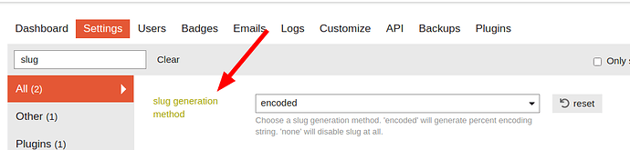

You can fix the problem by changing your site’s slug generation method setting to encoded.
After you do that you should be able to access the category again. If you would like to allow non ascii characters like š to be used in URL slugs for your site, keep the slug generation method set to encoded. If you would not like to have non ascii characters in your URLs, edit the category’s slug and then change the slug generation method back to its default value of ascii.

Thank you very much. That did the trick.
