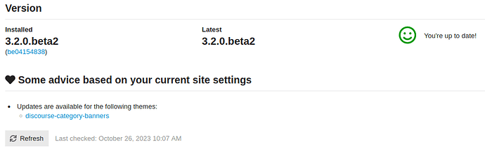

Hi @tgxworld, thank you for the reply.
Yes, I’m running the v3.2.0.beta2 tag (be04154838):
The plugin API version supported by this release is 1.14.0:
