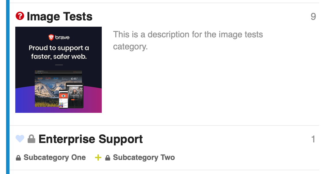

Here’s another example of the component affecting the layout
Before:
After:
Yes, that is normal, updates will reset everything but the theme settings. You should add the custom icons in a separate theme component.
For the layout changes: yes, there is some css in the component that could be conflicting with your theme. Probably easy to fix if you look at the source and see which css rule is causing the image to no longer float.

I took a look at the css in your component and cannot figure out why it’s doing this on my site. As I said I have tried this with a theme that has zero css and only activated this component so it’s not an issue with a conflict, it’s an issue with having a category logo image, have you tested the component with a category logo image?
Ah, the category logos were an oversight. Sorry about that! I just submitted a PR for @pmusaraj to review. I’m pretty sure I have all scenarios covered now, but if you notice anything off with the category list section, please mention me and I’ll take a look.
https://github.com/pmusaraj/discourse-category-icons/pull/2
Awesome, thanks @tshenry, the PR is now merged.

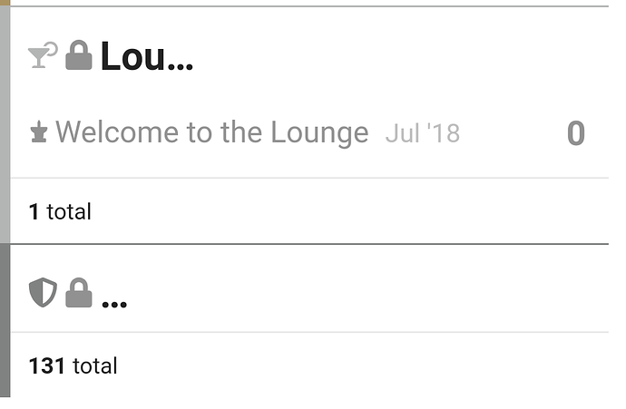

Thanks guys! One more tiny problem, on mobile the category title is being constrained to about 200px wide rather than full width, I’ve verified it is caused by this component.
Edit: One more little thing, the category icons push the category logo to the right and looks a bit sloppy
After the latest commit some (but not all) category names on mobile are truncated (the last one below is Staff):
If the component is disabled the category names are displayed in full. @tshenry can you help?
I just merged @tshenry’s latest PR, it should fix the 2-3 issues just above.
