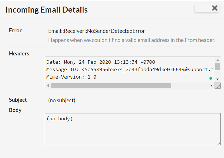

Yes, sidekiq is running. I checked the /admin/email tabs - looks like my “emails” are actually rejected.
This is what I get:
I inserted the same email text in the “Advanced text” tab, and it seems to be working, if each part (Date, From, To, Subject) starts with a new line, and the body is separated by two line breaks. When inserting the text exactly like in curl, it returns nothing. Could it be the line breaks in the raw email? If yes, what should I do?
I tried, /n, %0A and $'[text/n]', neither works.
I’m not sure. Looks like it doesn’t like any of the fields in your email.

You were right - that was a newline issue. I tried the same API call from Postman, and it worked - a new staged user was created and a topic on his behalf.

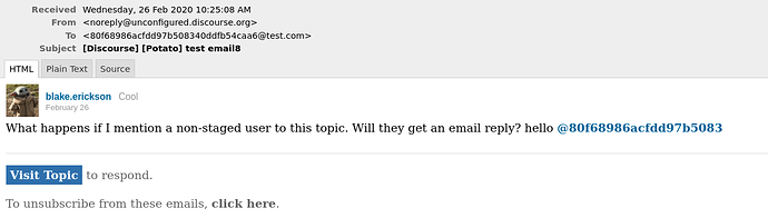

I think this is by design and the same happens if you send an email to a Discourse group. It is designed to work just like email as in the user might not even know they are sending an email into a Discourse forum. If I send you a regular email to your email account I don’t get a reply back from your email provider that says you received my email, we just trust that it works.
Here is an example email notification a staged user will receive:

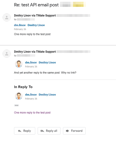

but this is what a non-staged user will receive:
There appears to be a difference between staged users and non-staged users. Likely because the user is staged it is to be just like interacting via regular email.

Well, for me the post notification doesn’t really look like a regular email anyway - e.g. it has a link to the post author’s profile at the forum (twice!), but not to the topic.
Besides, I would like to inform the staged user, that he can actually sign in to the forum.
