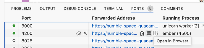

  7. Visit the “Ports” tab, and click the :globe_with_meridians: button for port 4200. This will open a new tab showing your development copy of Discourse
  8. All done! You can now make changes in the codespace and see them reflected in the preview.
