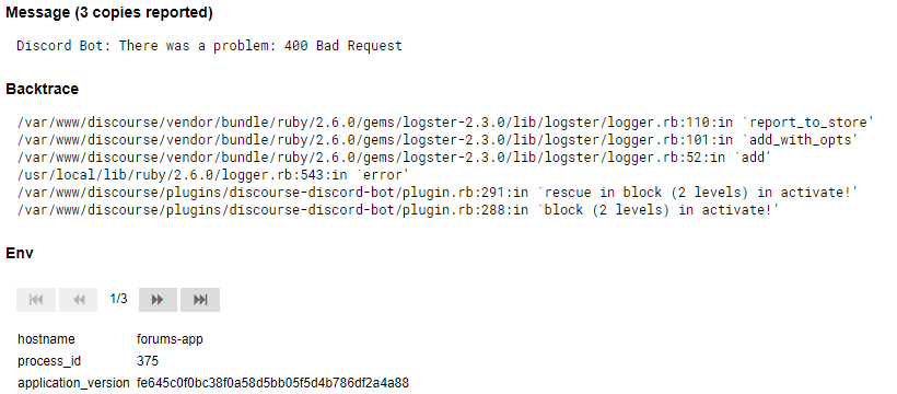

Got this during rebuild:
Bot is still offline. Triple checked everything and it’s all set up correctly. Not sure how to proceed now
 Maybe I need to open a port on my server instance?
2 « J'aime »
Thanks for testing this out and so soon after the update. Let me try to reproduce and I will revert. I did not change anything wrt to the port config.
2 « J'aime »
No issues rebuilding here, Bot comes up fine
 have you changed anything in your server config in between?
Your 400 Bad Request sounds like your server sent a corrupt or bad request to the Discord server and this was the response. This suggests it received it fine and was not blocked.
You can get this for:
  • malformed requests
  • lack of authorisation
  • exceeding rate limits
Unfortunately the error message doesn’t appear to help us determine which of these was the particular issue.
Presumably your Discourse is up? Check all the plugin settings are populated correctly.
Just to rule out a temporary gremlin run ./launcher restart app when you get chance
 this will take your site down for a few seconds only (sorry about that!).
I see it runs the bot in the after_initialize block, so it will prevent migrations (and rebuilds) if the bot is misconfigured, or if Discord is down.
Maybe try to handle this exception and just log it?

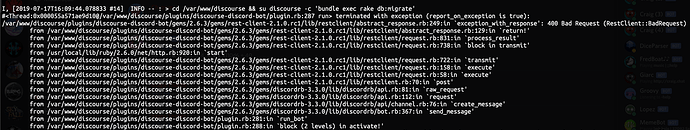

First I want to say thank you for making this, once I can get it working its going to be a huge help for us managing our discourse and discord for a volunteer community.
I am running into a 400 error when trying to run this bot. Prior to this plugin being added we have been successfully using the official discord auth plugin and webhooks via the chat integration plugin. I’ve validated that those are both still working appropriately.
I created the bot within the same discord app I’d previously created authorized the bot within the discord server, it shows up in the member list as offline. Your documentation didn’t say what permission value to apply, but given most bots I’ve encountered for discord asked for it I went ahead and set it up with a permissions value of 8 for Administrator.
Within the discord server I then copied the ID of the Role it created, which was named after my app, and the id of the channel for admin text.I added the app Role to that channel with full rights, just to be sure, then added the IDs to discourse and restarted.
Unfortunately no matter what I try I’m getting a 400, I even tried a rebuild just to be sure.
3 « J'aime »
Thank you, kind words. It was also enabled by the generosity of funders.
Yes, that’s great. It should have Admin.
This is the second report of this issue.
If you intentially remove the last char of the token in settings (remember what this is) do you get a 401 instead?
Let’s move this to PM because it might get messy :wink: (we can always post the solution here).
4 « J'aime »
Just to post an update in case anyone else sees this, we’re actively looking into the issue but haven’t yet narrowed down the cause. I’d say if anyone else is running into this issue please say so would help to have others testing.
1 « J'aime »
This is now fixed. It was a weird one to track down.
Thanks to @ransim for raising and working with me to get to the bottom of it.
Huge thanks to the #ruby_discordrb gang on Discord API for their patient and instant help!
https://github.com/merefield/discourse-discord-bot/pull/2
