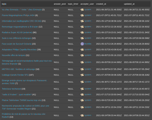

Steven reports a database error during a rebuild on a Discourse forum, where the discourse_solved_solved_topics table violates a not-null constraint on the answer_post_id column. The issue arises from invalid data—specifically, newline characters in the answer_post_id field—caused by a migration. Pfaffman and JammyDodger suggest the database is corrupted and recommend deleting the problematic records directly, as the cleanup logic is tied to the solved plugin. They note that similar issues occurred in the past, with a prior fix attempted in a commit, and advise using Data Explorer to identify and remove the affected rows. While the error is rare, its recurrence suggests a possible edge case in the migration process. Steven, pfaffman, JammyDodger, Alexander_Wright, pfaffman, JammyDodger, JammyDodger
Hello everyone!
During a rebuild on a forum in the stable branch, I have an error related to the solved plugin.
Here are the logs:
2025-12-20 03:48:21.715 UTC [1122] discourse@discourse ERROR:  null value in column "answer_post_id" of relation "discourse_solved_solved_topics" violates not-null constraint
2025-12-20 03:48:21.715 UTC [1122] discourse@discourse DETAIL:  Failing row contains (3735, 35506, null, -1, null, 2021-05-12 18:38:58.11516, 2021-05-12 18:38:58.11516).
2025-12-20 03:48:21.715 UTC [1122] discourse@discourse STATEMENT:  INSERT INTO discourse_solved_solved_topics (

I need to tell you that I suck at sql queries, especially via command lines. I don’t really trust myself to delete these lines via terminal.
But anyway, what route do you recommand for me to fix this? A query (what type of querie?) ? A script, or something can be done in the forum directly?

The ones where the post_id is Newline are the issue. You should just delete those records from the database (it might be possible from rails). You can probably get Ask.discourse.com to tell you how.
As a possible punt… I believe deleting a topic now automatically removes the solution and deletes the record in discourse_solved_solved_topics. I’m not 100% that this could work without the solved plugin installed, but it could be worth a check?
If you run a query in data explorer to grab them all, delete one, and run the query again to see if it’s disappeared, that could be an easy way to see if it could work?
Restoring the topic doesn’t restore the record in discourse_solved_solved_topics, so (potentially :slight_smile:) a quick ‘delete and restore’ could clear them out. :crossed_fingers:
I’m fairly certain that it won’t since the code that does that is in the plugin.
I’m also fairly certain that the database is broken. It’s not supposed to have newlines in that value column. Deleting them from the database is what needs to happen. If you don’t, you’ll forget when you try to move to a new server and restore this database (and it’ll have solved because it’s in core) and you’ll have to figure this out all over again.

Thanks @pfaffman and @JammyDodger, I’ll dig in the db to try to fix this.
With data explorer, I have the list of problematic rows, we can see this is very limited in time, maybe a bit of an issue with the plugin during that time?

It should be pretty easy to get Ask.discourse.com to give you a query that will find all of the ones you want to delete and (after you’ve seen that part of the query works) delete them all.
Having the system user as the one who marked solved is a bit unusual in there too. I think that was also the same for Alexander, looking at his error.
With two similar reports, do you think this could be a case of the migration missing an edge case, @pfaffman?
I wouldn’t hazard a guess.
I suppose two in eight months isn’t exactly a flood, so perhaps not enough to dig deeper. :slight_smile:
It looks like the other report has a similar date range too:
Not hugely useful to know for the task in hand, but possibly helpful if more reports come in.
