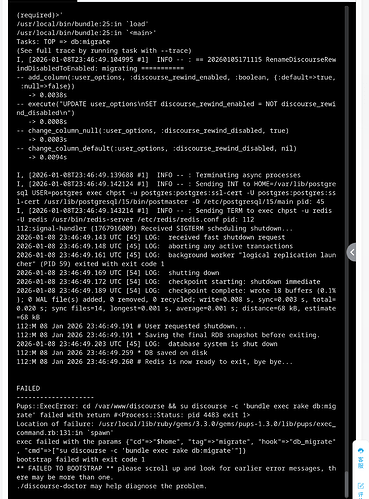

Errore di migrazione in 'rename_discourse_rewind_disabled_to_enabled'
La ricostruzione è fallita~ Il log è il seguente:
discourse -c 'bundle exec rake db:migrate'
rake aborted!
StandardError: Si è verificato un errore, questa e tutte le migrazioni successive sono state annullate: (StandardError)
You must drop a column's default value before marking it as readonly
I, [2026-01-08T16:18:49.016491 #1]  INFO -- : Terminating async processes
I, [2026-01-08T16:18:49.018961 #1]  INFO -- : Sending INT to HOME=/var/lib/postgresql USER=postgres exec chpst -u postgres:postgres:ssl-cert -U postgres:postgres:ssl-cert /usr/lib/postgresql/15/bin/postmaster -D /etc/postgresql/15/main pid: 46
I, [2026-01-08T16:18:49.020147 #1]  INFO -- : Sending TERM to exec chpst -u redis -U redis /usr/bin/redis-server /etc/redis/redis.conf pid: 113
2026-01-08 16:18:49.019 UTC [46] LOG:  received fast shutdown request
113:signal-handler (1767889129) Received SIGTERM scheduling shutdown...
2026-01-08 16:18:49.023 UTC [46] LOG:  aborting any active transactions
2026-01-08 16:18:49.034 UTC [46] LOG:  background worker "logical replication launcher" (PID 60) exited with exit code 1
2026-01-08 16:18:49.040 UTC [55] LOG:  shutting down
2026-01-08 16:18:49.042 UTC [55] LOG:  checkpoint starting: shutdown immediate
2026-01-08 16:18:49.057 UTC [55] LOG:  checkpoint complete: wrote 32 buffers (0.1%); 0 WAL file(s) added, 0 removed, 0 recycled; write=0.007 s, sync=0.004 s, total=0.017 s; sync files=16, longest=0.002 s, average=0.001 s; distance=180 kB, estimate=180 kB
2026-01-08 16:18:49.067 UTC [46] LOG:  database system is shut down
113:M 08 Jan 2026 16:18:49.108 # User requested shutdown...
113:M 08 Jan 2026 16:18:49.108 * Saving the final RDB snapshot before exiting.
113:M 08 Jan 2026 16:18:49.123 * DB saved on disk
113:M 08 Jan 2026 16:18:49.123 # Redis is now ready to exit, bye bye...
FAILED
Pups::ExecError: cd /var/www/discourse && su discourse -c 'bundle exec rake db:migrate' failed with return #<Process::Status: pid 4483 exit 1>
Location of failure: /usr/local/lib/ruby/gems/3.3.0/gems/pups-1.3.0/lib/pups/exec_command.rb:131:in `spawn'
exec failed with the params {"cd"=>"$home", "tag"=>"migrate", "hook"=>"db_migrate", "cmd"=>["su discourse -c 'bundle exec rake db:migrate'"]}
bootstrap failed with exit code 1

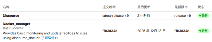

Ho lo stesso problema dopo l’ultimo aggiornamento.
La correzione di @zogstrip per quella migrazione è ora disponibile in latest, quindi eseguire un altro aggiornamento dovrebbe far funzionare di nuovo le cose.
2 Mi Piace
Ho appena ricostruito, ma non funziona ancora

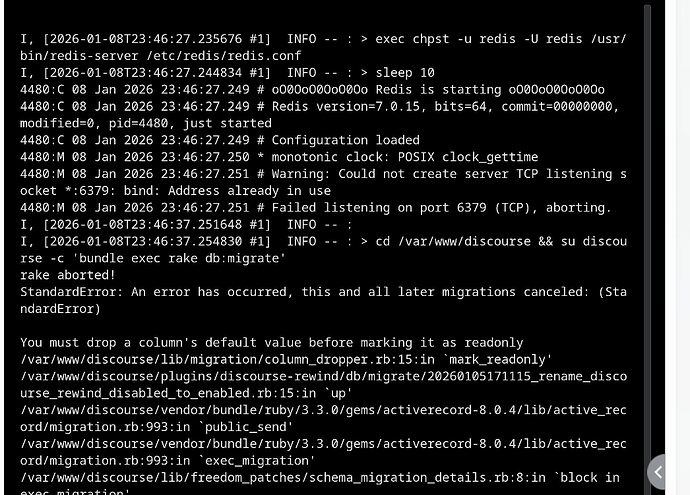

再試了一次 rebuild 還是失敗了,是什麼原因?
I, [2026-01-09T05:09:31.402079 #1]  INFO -- : > exec chpst -u redis -U redis /usr/bin/redis-server /etc/redis/redis.conf
I, [2026-01-09T05:09:31.409979 #1]  INFO -- : > sleep 10
4481:C 09 Jan 2026 05:09:31.416 # oO0OoO0OoO0Oo Redis is starting oO0OoO0OoO0Oo
4481:C 09 Jan 2026 05:09:31.416 # Redis version=7.0.15, bits=64, commit=00000000, modified=0, pid=4481, just started
4481:C 09 Jan 2026 05:09:31.416 # Configuration loaded
4481:M 09 Jan 2026 05:09:31.417 * monotonic clock: POSIX clock_gettime
4481:M 09 Jan 2026 05:09:31.418 # Warning: Could not create server TCP listening socket *:6379: bind: Address already in use
4481:M 09 Jan 2026 05:09:31.418 # Failed listening on port 6379 (TCP), aborting.
I, [2026-01-09T05:09:41.418357 #1]  INFO -- :
I, [2026-01-09T05:09:41.421210 #1]  INFO -- : > cd /var/www/discourse && su discourse -c 'bundle exec rake db:migrate'
rake aborted!
StandardError: An error has occurred, this and all later migrations canceled: (StandardError)
/var/www/discourse/lib/migration/column_dropper.rb:15:in `mark_readonly'
/var/www/discourse/plugins/discourse-rewind/db/migrate/20260105171115_rename_discourse_rewind_disabled_to_enabled.rb:15:in `up'
/var/www/discourse/vendor/bundle/ruby/3.3.0/gems/activerecord-8.0.4/lib/active_record/migration.rb:993:in `public_send'
/var/www/discourse/vendor/bundle/ruby/3.3.0/gems/activerecord-8.0.4/lib/active_record/migration.rb:993:in `exec_migration'
/var/www/discourse/lib/freedom_patches/schema_migration_details.rb:8:in `block in exec_migration'
I, [2026-01-09T05:09:52.683547 #1]  INFO -- : Terminating async processes
I, [2026-01-09T05:09:52.684945 #1]  INFO -- : Sending INT to HOME=/var/lib/postgresql USER=postgres exec chpst -u postgres:postgres:ssl-cert -U postgres:postgres:ssl-cert /usr/lib/postgresql/15/bin/postmaster -D /etc/postgresql/15/main pid: 45
112I, [2026-01-09T05:09:52.685640 #1]  INFO -- : Sending TERM to exec chpst -u redis -U redis /usr/bin/redis-server /etc/redis/redis.conf pid: 112
:signal-handler (1767935392) Received SIGTERM scheduling shutdown...
2026-01-09 05:09:52.686 UTC [45] LOG:  received fast shutdown request
2026-01-09 05:09:52.691 UTC [45] LOG:  aborting any active transactions
2026-01-09 05:09:52.708 UTC [45] LOG:  background worker "logical replication launcher" (PID 59) exited with exit code 1
2026-01-09 05:09:52.713 UTC [54] LOG:  shutting down
2026-01-09 05:09:52.716 UTC [54] LOG:  checkpoint starting: shutdown immediate
112:M 09 Jan 2026 05:09:52.718 # User requested shutdown...
112:M 09 Jan 2026 05:09:52.718 * Saving the final RDB snapshot before exiting.
2026-01-09 05:09:52.734 UTC [54] LOG:  checkpoint complete: wrote 17 buffers (0.1%); 0 WAL file(s) added, 0 removed, 0 recycled; write=0.007 s, sync=0.004 s, total=0.020 s; sync files=14, longest=0.002 s, average=0.001 s; distance=71 kB, estimate=71 kB
2026-01-09 05:09:52.750 UTC [45] LOG:  database system is shut down
112:M 09 Jan 2026 05:09:52.763 * DB saved on disk
112:M 09 Jan 2026 05:09:52.763 # Redis is now ready to exit, bye bye...
FAILED
Pups::ExecError: cd /var/www/discourse && su discourse -c 'bundle exec rake db:migrate' failed with return #<Process::Status: pid 4484 exit 1>
