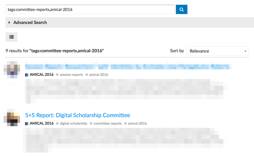

Penso che ci sia un bug nella ricerca di più tag. Ecco il risultato strano che ho ottenuto su Discourse:
cimg src=“//cdck-file-uploads-global.s3.dualstack.us-west-2.amazonaws.com/meta/original/3X/9/d/9d9e5d0ba84892a132ca1505ed87d1e7deb222b4.png” width=“690” height="428"e
Basandomi sulla ricerca, dovrebbero esserci 8 risultati. Ma ne mostra 9. Il secondo risultato è corretto, ma non il primo.
Mi chiedo se il problema sia legato al trattino, dato che anche il risultato sbagliato contiene un tag ‘a’ che include alcuni dei termini di ricerca (-reports). Il problema non si verifica quando si cerca semplicemente committee-reports.
I might be reading this wrong, but wouldn’t this simply imply the topic only needs to contain one of the provided tags?
Or am I reading that incorrectly?

Is there a way to search for two tags with AND instead of OR?

FWIW, I was just doing a multiple tag search to share a list of posts with someone and expected the search would return the intersection (AND) instead of the union (OR). So, found this post and adding a +1 :thumbsup: for the option to AND multiple tags in a search.
2 Mi Piace
@burke, you can actually do it but it isn’t performant (depending on the number of tags and topics you have)
Multiple Tags search query takes too long ? - big forum - #3
You would specify the tag item multiple times, such as tag:pr-welcome tag:foobar
7 Mi Piace

https://github.com/discourse/discourse/pull/4896
With this pull request now it is possible to do logical AND search by multiple tags and the performance is the same for any number of tags. Example search: tag:pr-welcome+foobar
