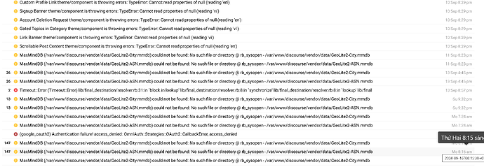

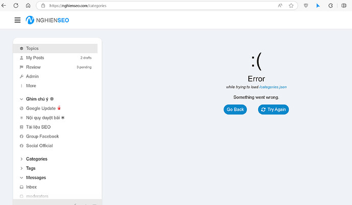

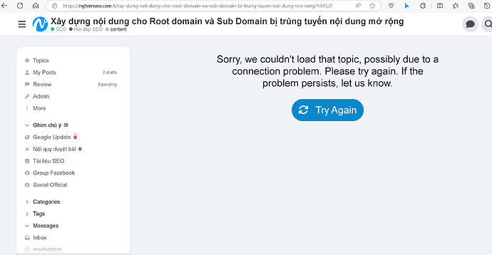

Hello Discourse support team, 1-2 days ago I updated the Discourse version in …/admin/update and then the following errors occurred:
  1. And some other errors in the attached image, even though I have rebuilt on the server and enabled the default theme of Discourse, this error is still there.
I hope to get support to fix this, I am really worried about these errors. Thanks a lot!!!
The first error looks like a translation is missing, which isn’t a show-stopper.
My guess is an errant plugin.

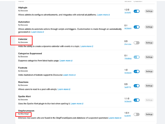

Do you have any non-Discourse plugins installed?

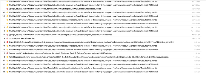

What to you see at /admin/logs ?
I just loaded /categories at your site and don’t get an error. Is it still happening?

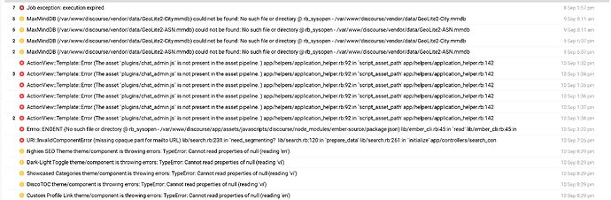

Here are my website logs: https://nghienseo.com/logs/ (also because I’m new to Discourse so I don’t know how to look at /logs to find the error I’m having)
I have attached the Plugin I’m using. It’s true that a few days ago I installed 2 more plugins: Stopforumspam vs Calendar.

Remove stop forum spam
I removed the stop forum spam plugin but the above errors still remain. :worried: @pfaffman
Without being an admin on your site, we can’t view those, could you screenshot the tab perhaps?
Also, are there any errors in the browser console of your site? That could also help narrow down the issue.

Here is my /logs (image attached)
I also rebuilt and some other errors I posted at the beginning of the article

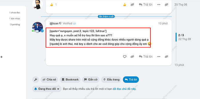

In addition, when replying using quote, the code error is as shown in the picture.
The [/quote] has to be on its own line.
[quote=“Toan Nguyen, post:12, topic:327071, username:toanvoc”]
[/quote] doesn’t work
[quote="Toan Nguyen, post:12, topic:327071, username:toanvoc"]
[/quote]
works
works

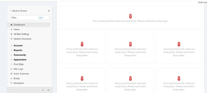

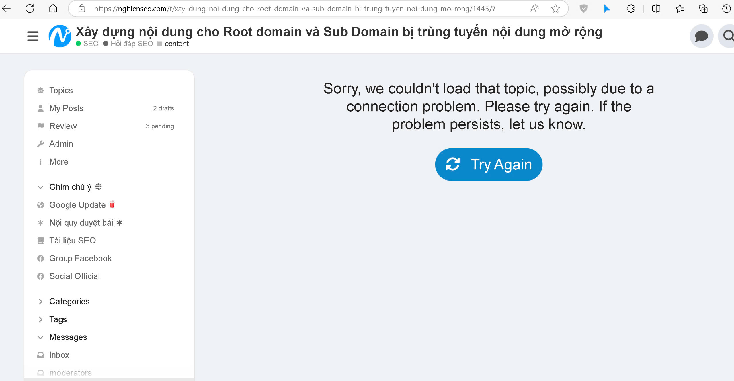

I have edited my original post because some errors have been fixed by the community. Currently, I only have these serious errors. If you can support me to answer or fix them, I would be very grateful.
Erorr 1:
