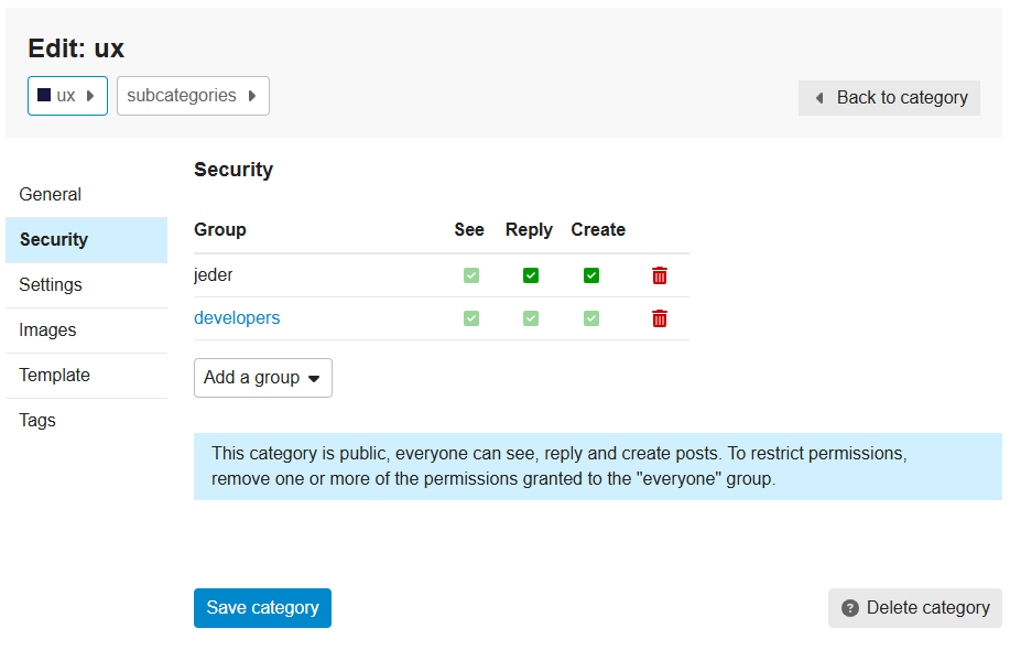

I accidentally switched the default locale of my forum to English for a longer time span, so the default groups were renamed and discovered some features related to category permissions and the “everyone” group.
The first difference I noticed was the banner at the bottom.
Then I noticed that while the German “jeder” links to /g/jeder (which doesn’t work, because there is no such group), the English “everyone” isn’t a link.
And third, I learned that when you add another group like “moderators” in English, all permissions are added by default and you are not allowed to remove them, while “everyone” is allowed to do it. In German, this additional help does not work; you can easily remove permissions even though “everyone” is allowed.

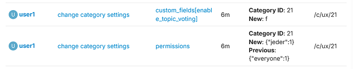

The staff action logs are also a little confusing, because it looks like I changed the group, but I did not; I have only clicked “save”, and then the log shows the “everyone” group in two languages:

I think the problem why the link on “jeder” is not suppressed as the link on “everyone” is the fact that “everyone” was hard-coded in the check:
And in a similar way, “everyone” is also hard-coded for the warning shown below and the checkboxes being disabled:
I think it would be safest to check the ID instead. If you use the name of the everyone group based on the default language of the forum, this would still mean that the names would not match between a change of forum language and the execution of the DBConsistency job.

The banner, the disabled checkboxes, and the link on the everyone group are fixed.

If the locale is German, so the group is “jeder,” and I save a category without changing anything, I see this in my staff action logs.
If the locale is English and the group’s name is “everyone,” and I save the category, no permission change is logged.
It’s not because the last time the category was saved the name was different. I can press “save” several times, and each time the log says the permission was changed from “everyone” to “jeder.”
