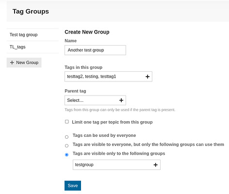

I just tried testing this with Discourse Version - 2.9.0.beta3, however, I was unable to reproduce the issue.
Specially, I setup a tag group with settings similar that what you described, ie - “Tags are visible for everyone, but only the following groups can use them” and then selected two groups and clicked save.
After reloading, the two groups were both visible, and upon clicking the “Tags are visible to everyone…” menu, both groups were able to be deselected.
I used Chrome Version 99.0.4844.84 to access Discourse, and also tested with another admin on the site using Firefox 91.7.1esr and was still unable to reproduce the issue.
I hope this helps provide some insight into this bug.

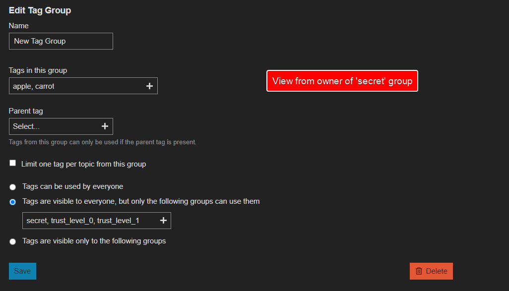

After further testing, I found that if a specific group is not visible to the moderator editing the tag group settings than that group will not show up on the edit tap group page.
More details about the testing process I went through:

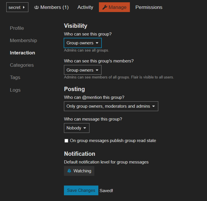

The “secret” group that is only visible to the group owner.

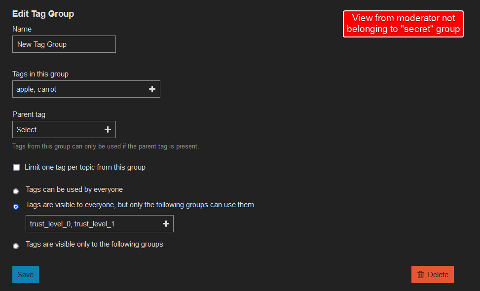

Tag Group Setting as seen from owner of “secret” group, after adding '“secret” group.
View from other moderator outside of “secret” group. The “secret” group is unable to be seen.
That all being said, I believe this is working as intended, since the group in question would be hidden from that moderator anyways, however, that moderator wouldn’t be able to add that group to the tag group settings, as they wouldn’t be able to see anything related to that group at all.

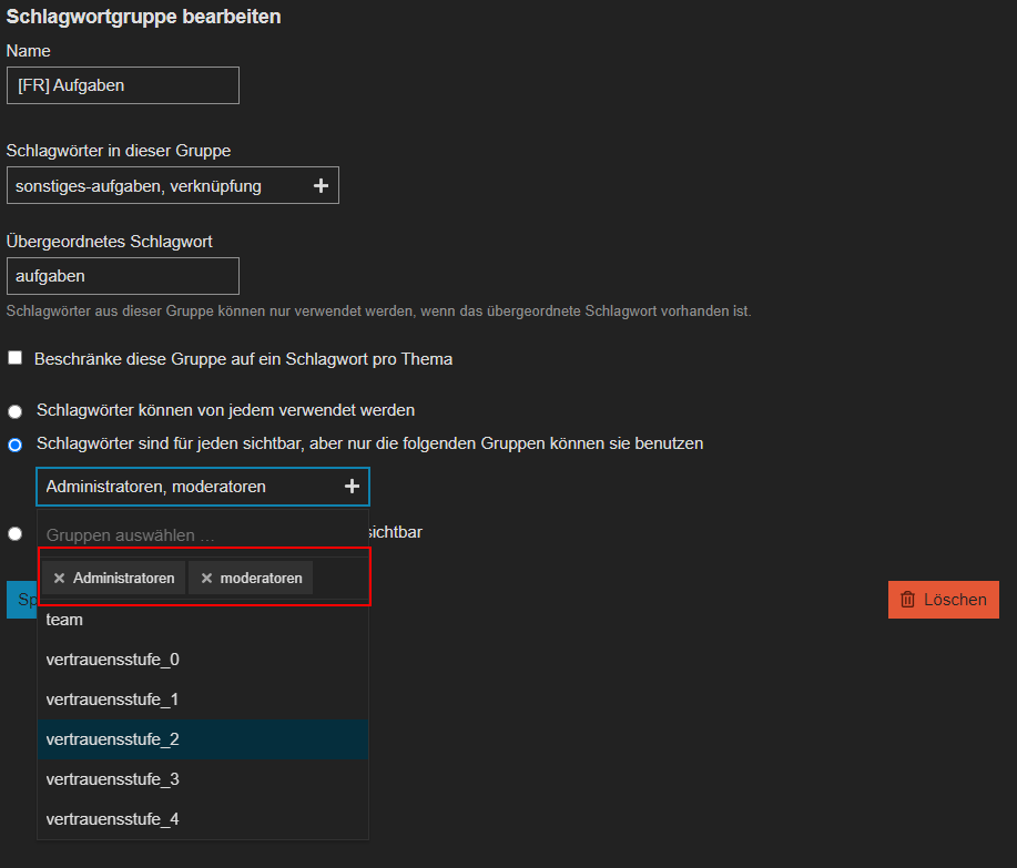

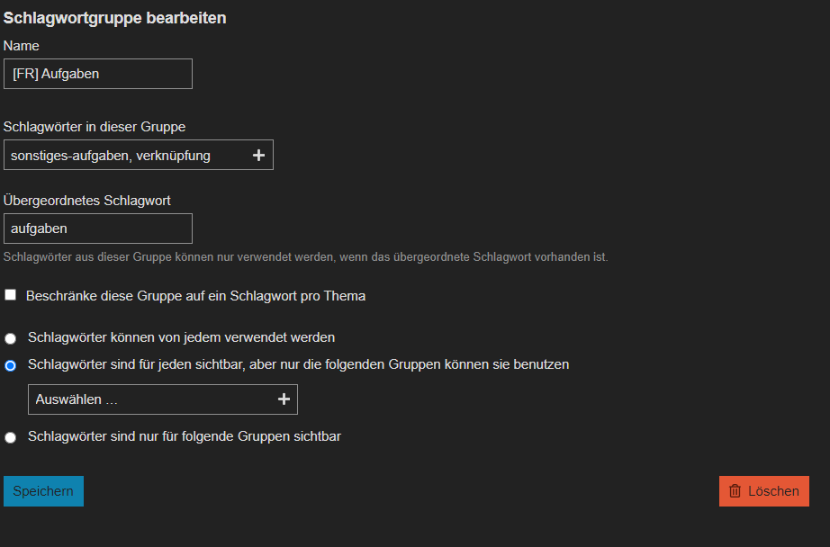

Thank you for your response and for trying to recreate the problem.

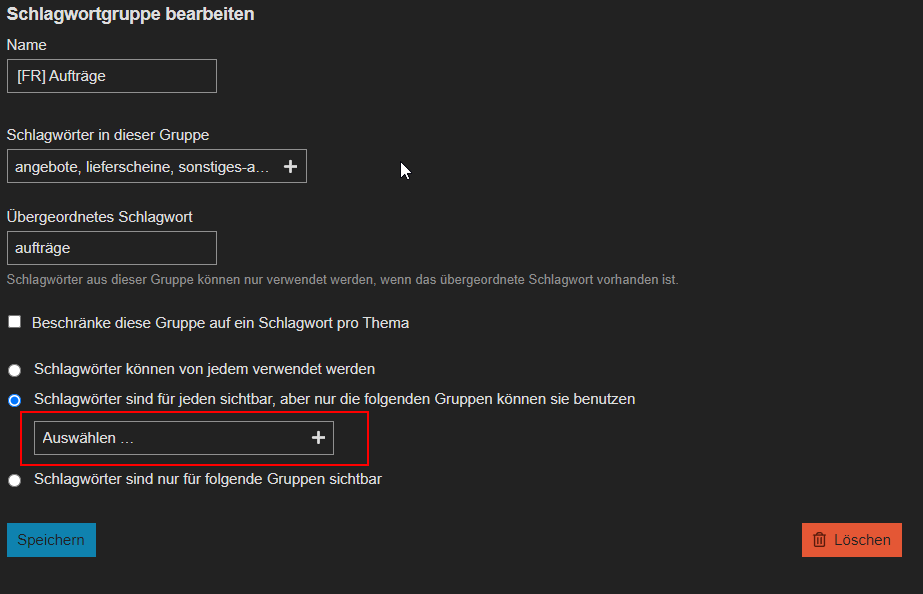

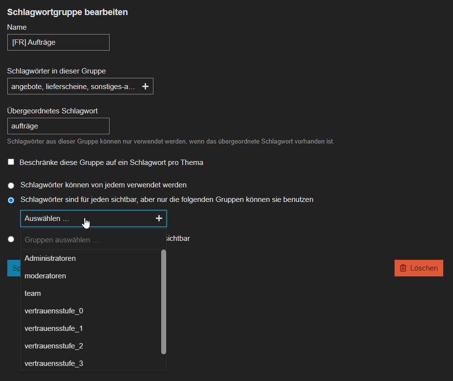

To understand the problem even better, I have attached screenshots here. You can see that I authorize the two groups “Administrator” and “Moderator” to use these tags.
After I close the page and open it again, these two groups are no longer selected, which would mean that the two “roles” would no longer have the sole right to use the tags in the tag group. But these two still have only the right to use the tags. So the problem is that it does not save the two roles as set.
And
I hope this could be understood better.
Excuse me, small addition, since here by mistake the wrong group is to be seen in the Screenshot above, it concerns here naturally this group:

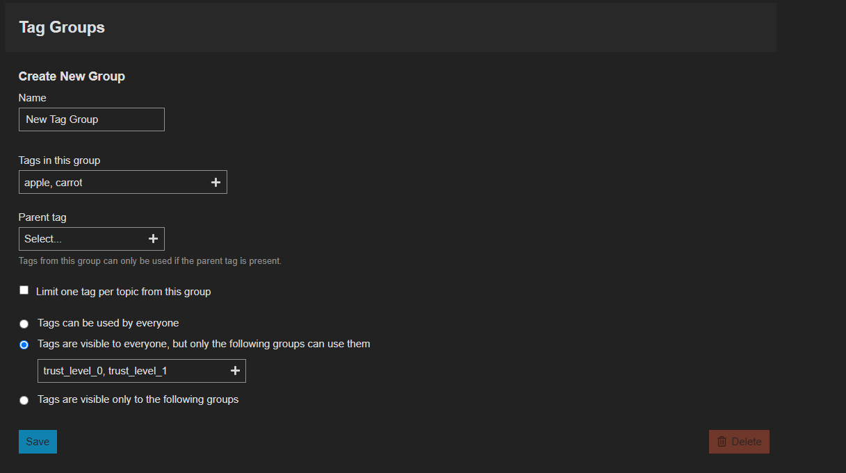

Tag group settings:

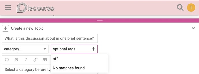

It doesn’t matter what I use on Tags are visible only to following groups it will disapper right away from there if a reload, visit some other page and then come back or doing log out/login.
If I don’t return to tag group settings I can see that limited tga under its group on tag page. But it isn’t limiting anything.
Here I can limit visibility of one tag to TL2 but lower TLs see it anyway.

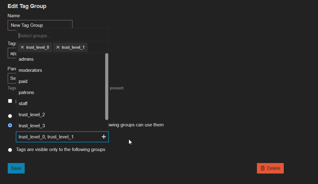

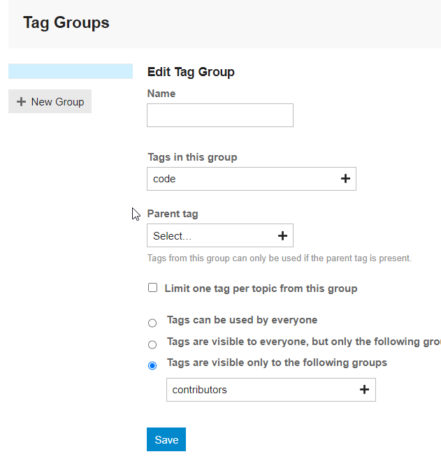

I don’t know if it’s what Jakke is talking about, but I have an odd experience on my dev install (latest):
So far, once saved, no issue.
When I reload, the group name doesn’t appear

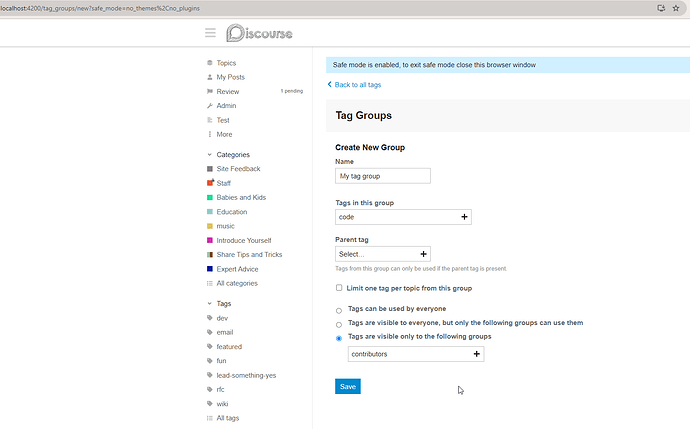

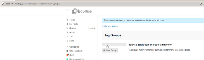

I have been trying to reproduce this but I cannot. I just did a fresh pull of latest commit. :thinking:

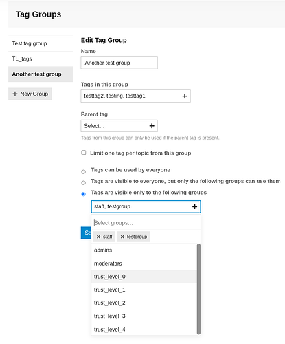

create new tag group:
saved and list shows tag group as expected, even when page is reloaded.
and when I reload that page I get the same expected result and I can edit that tag group again:

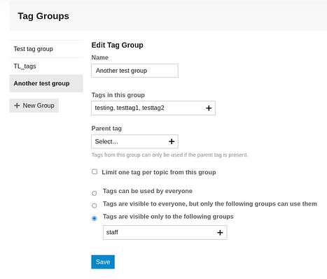

I limit this tag group to staff:

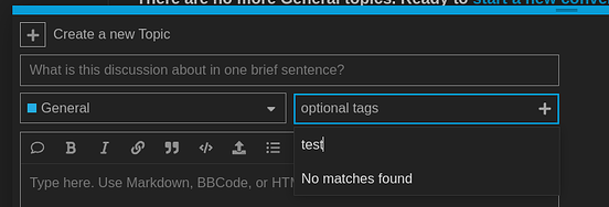

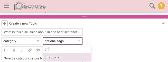

Try to find a tag in that tag group with a user who isn’t staff:
Darn. When I allow TL2 then my TL1 test person sees tag, but anons not.

But if used selfmade group as limiting one it stayed. A little bit more digging and one issue is automated groups that is translated. Like trustlevel_x vs. Finnish luottamustaso_x. Dsicourse just doesn’t accept translated ones. Well, with tag groups anyway.

I thought about that too. In this topic Non-english automatic groups don't stick when applied to Tag Group visibility/usability restrictions the German locale is used.

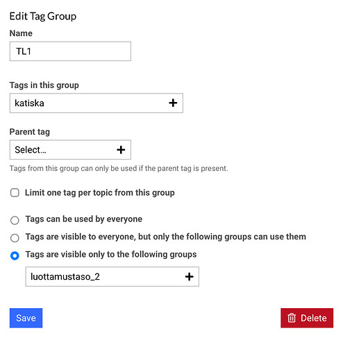

I think I have a repro:
  • Set default locale to ‘suomi’
  • Go to /sidekiq/scheduler page and trigger Jobs::EnsureDbConsistency (to ensure group names are updated)
  • Create tag group
  • Set the equivalent of ‘Tags are visible only to the following groups’ to luottamustaso_2
  • Save
  • Refresh page
  • Field is empty
  • Tag restrictions do not seem to apply
Obviously, my test site is in Finnish so I’m fairly confident of the result but not 100% confident as I don’t read Finnish and it can get a little confusing. :slight_smile: If someone else could repro that would also be great.
