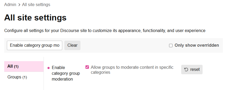

Let’s try to find out why it doesn’t work step by step:
Is the setting for category moderation enabled?
You can find it by searching for Enable category group moderation in your site settings
1 лайк
Yep! That’s enabled.
