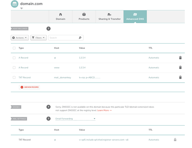

    Here is screenshot of the DNS records:
