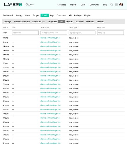

Maybe we have a setting askew somewhere. It certainly appears as if this Discourse instance is excited to be upgraded. Here’s the output of the /admin/email/sent screen:

How is your Discourse site hosted @lee7 ? Using our standard install instructions?
The version update emails are sent by a daily Sidekiq job:
There shouldn’t be any reason for the job to run more than once every day. We also have a check to make sure we only notify about a given version once.
All this data is stored in Redis… so my guess would be that you have an unusual Redis configuration?
