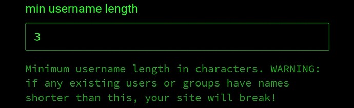

Wouldn’t that cause issues? The min username length setting advises that:
WARNING: if any existing users or groups have names shorter than this, your site will break!
Oh. Darn. I guess that won’t work. Maybe just having everyone use 6 letters isn’t so bad?
