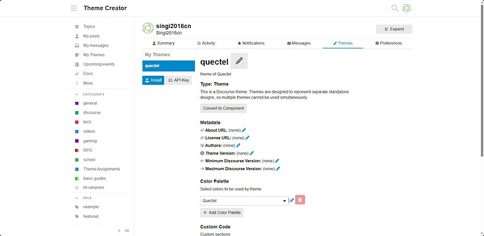

I followed the steps in Designers Guide: Getting Started with Themes in Discourse - Docs / Developer Guides - Discourse Meta, and everything went smoothly. However, after updating the code locally, the command line indicated it was synchronized. But I cannot see the latest code on My Themes - singi2016cn - Theme Creator, and the configuration on My Themes - singi2016cn - Theme Creator also doesn’t take effect.

Theme creator is definitely still supported, so please do report any critical issues.
From your screenshot. It looks like your theme was created successfully. Did you use the “Preview” button to see the theme in action?
