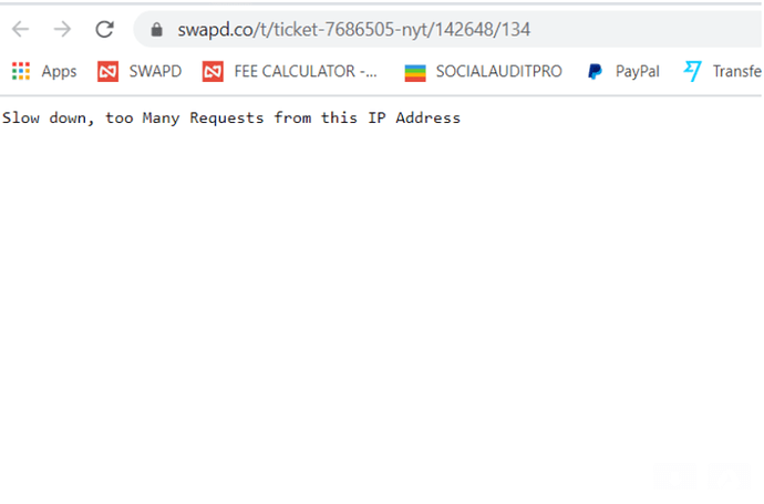

I can confirm, happening on my site. Getting this if we open too many things too fast:
Even liking things too fast can now cause 429 errors. All because of two little depreciated icons.
