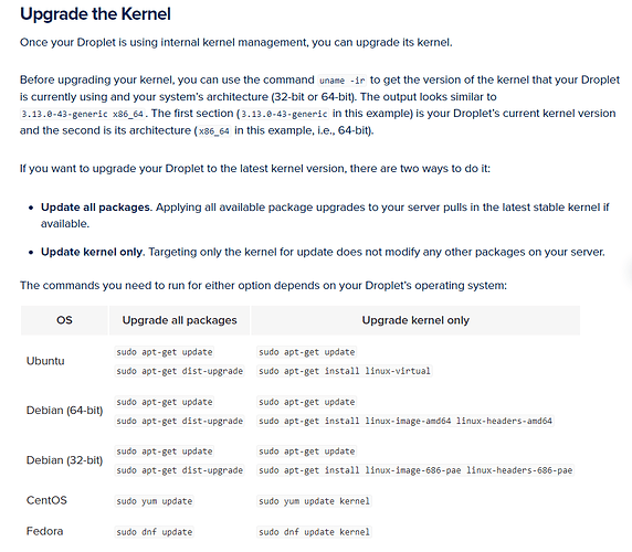

There is an option to upgrade the Kernel myself as Digital Ocean has explained here:
But I’m wondering:
  1. Should I worry about something else breaking on the server?
  2. Should I go for “Upgrade All Packages” option or “Upgrade Kernel Only” option.

Ubuntu wiki says a sudo apt-get -s install --install-recommends linux-generic-hwe-16.04 will give you their latest supported kernel (4.15) after a reboot. I’d backup, download the backup locally and give it a try.
https://askubuntu.com/questions/248914/what-is-hardware-enablement-hwe
