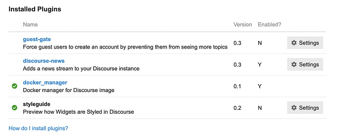

Here is what my plugin list looks like - so I guess the issue is the News plugin, is that correct?
so did you try disabling it?
Not yet - so I assume its safe to disable the news plugin (which will effectively break my site), wait for some time, then enable it again.
