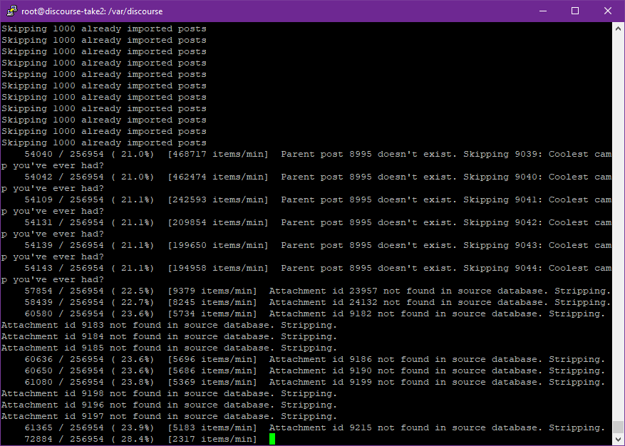

I’d say the biggest giveaway that the script isn’t picking up on your attachments is that it will be strangely quiet while instead it should probably be putting out the occasional error:
So if the import goes several hours without a single error listed, it’s probably not picking up the attachments.

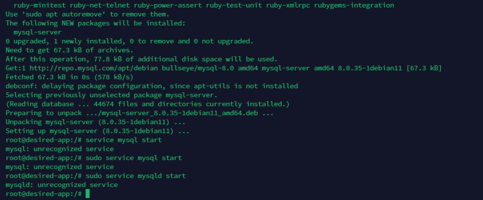

these instructions are outdated for Ubuntu 22.04?
After managing to get MYSQL installed this happens:
root@root-app:/# sudo mysql
ERROR 2002 (HY000): Can’t connect to local MySQL server through socket ‘/var/run/mysqld/mysqld.sock’ (2)
