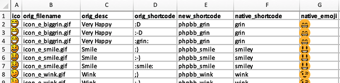

phpbb_smilies.zip (87.2 KB)
(compare to default smilies)
fwiw here’s my emoji solution
i give you two options:
  1. native
    • if you don’t want to preserve the original phpBB emoji, you can map them to native emoji already existing in discourse
:grin: :smile: :wink: :slightly_frowning_face: :astonished: :exploding_head: :confounded: :sunglasses: :joy: :rage:
:stuck_out_tongue: :person_facepalming: :sob: :imp: :smiling_imp: :roll_eyes: :exclamation: :question: :bulb: :arrow_forward:
:neutral_face: :smiley_cat: :nerd_face: :nerd_face:
  1. imported
    • if you want to preserve the original phpBB emoji and have them available as shortcodes to continue using:
      • before running the importer, go to the emoji section of the discourse dashboard (admin/customize/emojis)
      • if you want, first create an emoji group called phpbb or something
      • drag the emoji files (5 at a time) in the new_files onto the browser to import them as custom emoji
i have a zip with the config for either option included as import.yml in the zip.
also in the zip is a spreadsheet to help you decide or make your own mapping:
phpbb_smilies
├── phpbb_smilies.xlsx # master reference to help you decide
├── import.yml # config file with both options
├── orig_phpbb_smilies.csv # original phpbb data
├── orig_files # original phpbb emoji files
└── new_files # emoji files renamed to match the `new_shortcode` column in the spreadsheet
