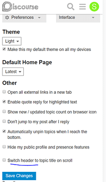

Lorsqu’il est désactivé selon les préférences utilisateur → interface :
L’utilisateur verra l’en-tête standard sans condition :
Lorsqu’il est activé, le comportement de « basculer vers le titre lors du défilement vers le bas » reste inchangé :
En tant qu’administrateur , dans la section des composants de thème, vous pouvez contrôler si cette option est désactivée ou activée par défaut :

To follow-up on @seanblue . The theme component installs without issue. I can see the component on the Theme list in Admin. We aren’t seeing the User > Preference > Interface option as seen in the quote.

@dylanh724 what issue are you seeing here? This theme does nothing on Desktop, so you’ll only see the new option on mobile.

I just signed up quickly, and I can see the setting in the user preferences on mobile:
Yep, that is located in the themes area. Find the page for the component, and then find the “theme settings” section at the bottom of the page. There’s a screenshot of it in the OP:

I can’t see it all – I wonder if this only works for new accounts? There’s a friend helping me test and he can’t see the option, either. I’m testing desktop, he’s testing mobile.
I did, however, find the theme option within the component (thanks):

Correct, you can only toggle the setting when using the mobile device. The theme component does absolutely nothing on Desktop.
