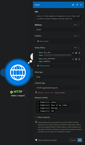

I want to automatically post a reply inside a topic as soon as I pushed a commit on a github repository - automatically via a webhook.
I work with Integromat and already successfully did something similar with topics
I have setup an API in Discourse, a webhook in Github, a HTTP POST scenario in Integromat but I’m missing the final piece to make it work.
My current attempt looks like this which does not work.
I think because Discourse does not know what to do with the POST request.
I mean there is /new-message? and /new-topic? but not /new-reply?
Maybe it’s something trivial, thanks in advance for your help!

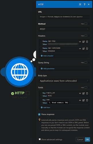

Just as info it is not failing because of the data fields but because of bad csrf.
See here:
@blake Does this mean I need to set the api_username and api_key in the Header?
My current progress which fails:
Yep, you will need to set the Api-Username and Api-Key in the header. Be sure to change the _ to a -. You will also need to remove the credentials from the body.

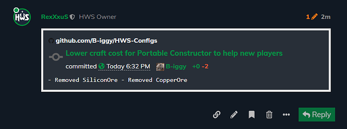

Awesome, thank you very much @blake!
That was it.
For someone searching for hours via Google and Search as I did, that’s it:
