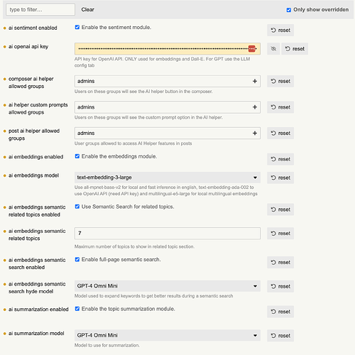

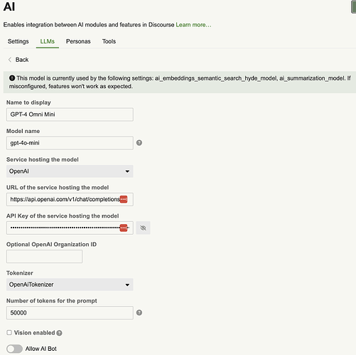

Can you share a screenshot of your exact config, and your llm config.
Overgrow
(OG)
September 16, 2024, 11:07pm
8
Sure, here are the settings
