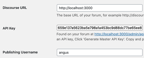

The first thing to sort out is the issue on the Connections tab. The plugin won’t work until you establish a connection with Discourse.
What have you set for the Publishing Username on that tab? It should be set to either the Discourse username of the system user (‘system’ by default) or the username of an admin user from your forum.

For the Publishing Username setting, you need to use the username of your Discourse System user. That username defaults to ‘system’ (without the quotes.) For the API Key, use the All Users API Key. You can find that key at /admin/api/keys.

Hi @angus , thanks for the response. Unfortunately, after creating the single user key as you stated, I still get the no connection message. I’ve tried everything I can think of but no joy…thanks again.
