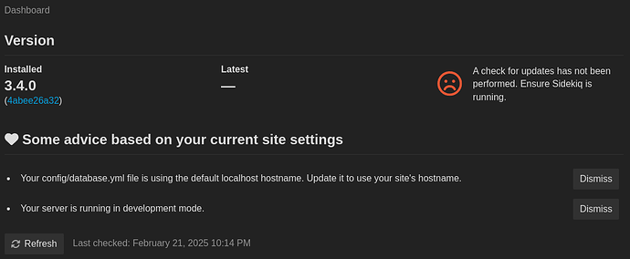

Well, I reinstalled Discourse at version 3.4.0:
However, I couldn’t get it to run in production mode. I’m not sure why. It just said “Oops …” and there wasn’t much that I could see in the logs. I think the problem might have been something to do with some proxy settings, but I’m not sure.
Anyway, I set RAILS_ENV back to “development” and it started. However, I’m still getting the same error when I try to connect from WordPress:
