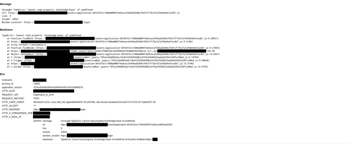

Indeed, under https://<HOST>/logs, I read the following: Uncaught TypeError: Cannot read property 'knowledge-base' of undefined

I have some thoughts on what might be causing it.
I’m curious, though – did you have any categories listed in the kb categories theme setting while it was enabled? I can see a case in the code where it may cause an issue if there are no categories selected.

Are you seeing those same errors in logs?
What’s happening here is there’s a route getting triggered that’s trying to look for the knowledge base component before it’s loaded.
Yeah, but they don’t stack anymore, but differ in the fourth line of their backtrace. The other lines look as above.
initialize/</<@https://<HOST>/theme-javascripts/<VARIES>.js?__ws=<HOST>:103:48
