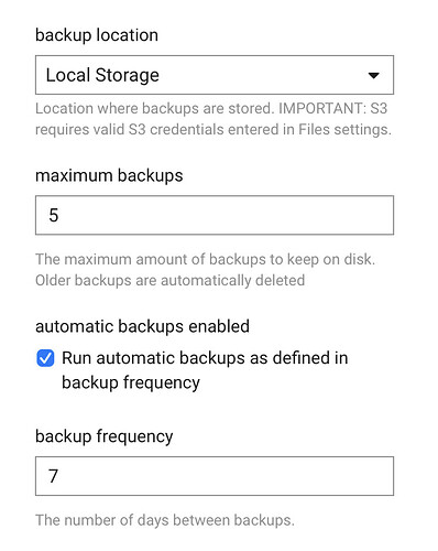

Sorry I’m cutting in, but is there something else that should clean every now and then?
After an app rebuild in the console, you can run ./launcher cleanup and that will clean up some old files.
The backups can be deleted from The GUI as well.
Discourse default setting is to retain 5 backups.
You can go into admin > backups and see the backups
