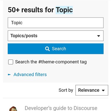

Searching on mobile without touching the checkbox
https://meta.discourse.org/search?context=tag&context_id=theme-component&q=Topic&skip_context=true

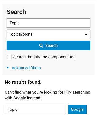

Searching on mobile & tapped checkbox once
https://meta.discourse.org/search?context=tag&context_id=theme-component&q=Topic&skip_context=false

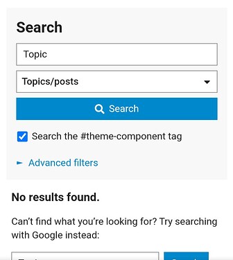

Searching on mobile & tapped checkbox twice

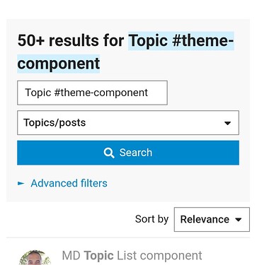

Searching using desktop-view
https://meta.discourse.org/search?q=topic%20%23theme-component
