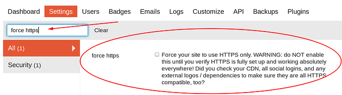

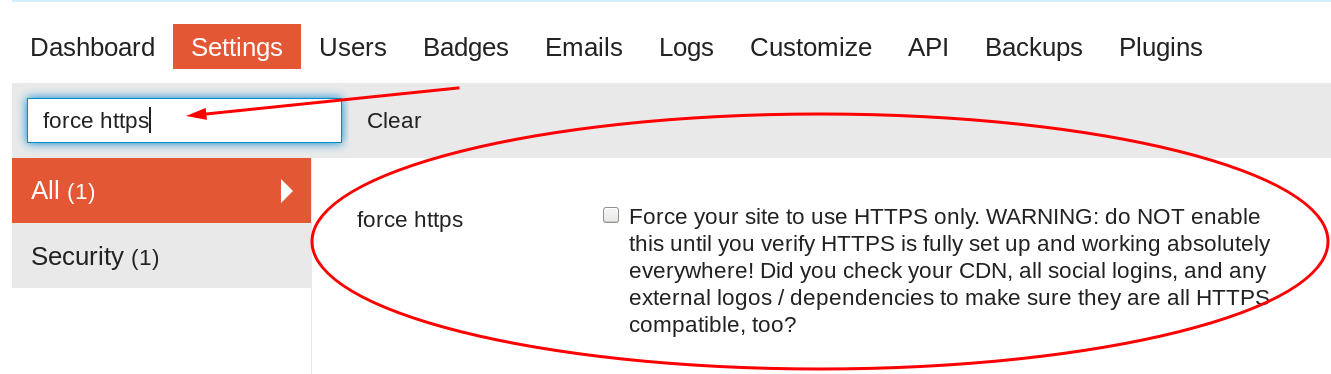

Did you enable force_https in the site settings?
I’m not sure, where does it located? (tried to search in the settings via the search bar). Should it be enabled? what does it do?

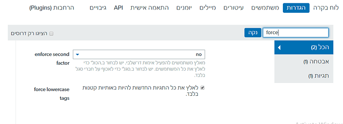

Don’t have it:
My discourse is in Hebrew. I tried to search through the customized text.
Something is wrong with your install, it looks like the install is botched somehow.

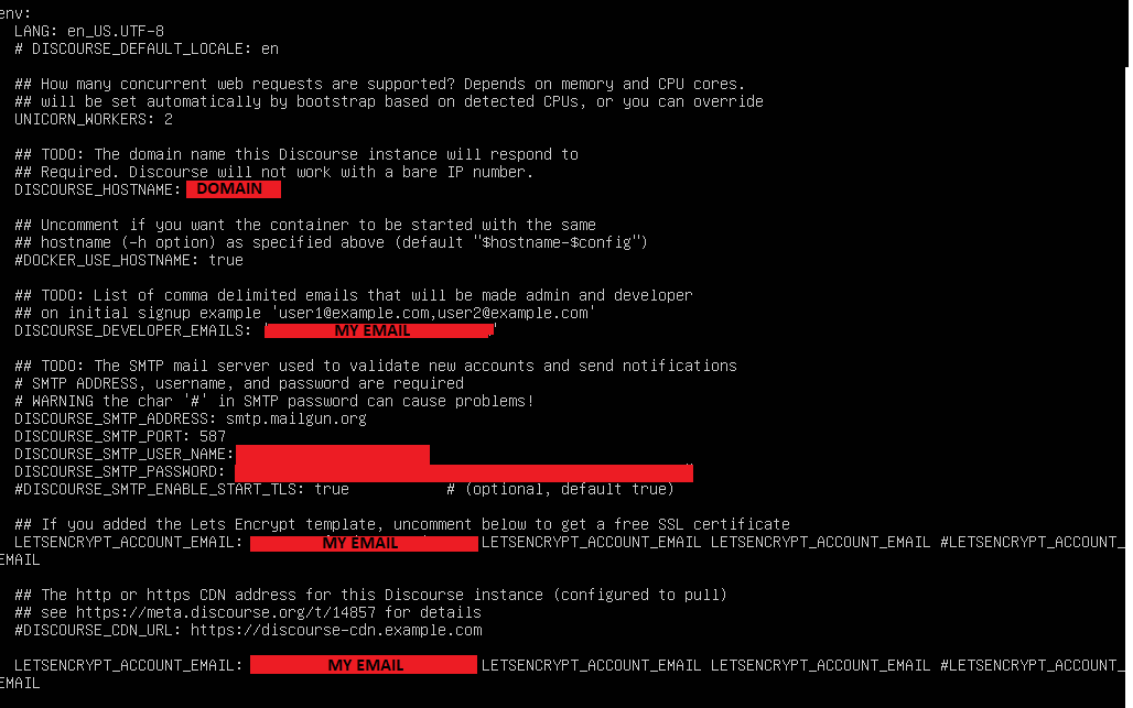

I used the following guide to enable HTTPS: Set up HTTPS support with Let's Encrypt.
Maybe it’s outdated or maybe I should have used another guide? I set there the env “LETSENCRYPT_ACCOUNT_EMAIL”.

I tried to rebuild it couple of time but it still keeps that message in the devtools. Maybe something wrong with the app.yml file?
I can’t see the problem though :confused:
