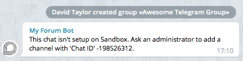

  1. Add your bot to a group chat on telegram (or just start a private chat with it)
  2. You should receive a message like this
    If not, try sending a message which starts with /getchatid
  3. Copy the Chat ID. If there’s a minus sign before it, make sure to include it - it’s very important!
