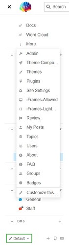

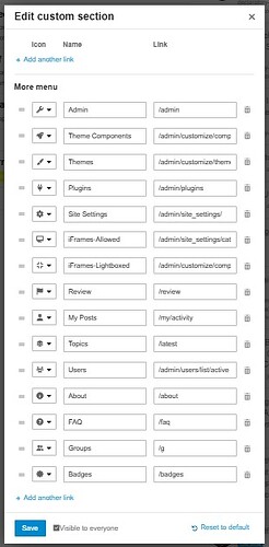

Site is started and here is the sidebar and …more items
Ok, it makes sense now. The migration expects at least 1 link outside ... more, but you have none so it blows up. I’ll update the migration so it accounts for this case.
