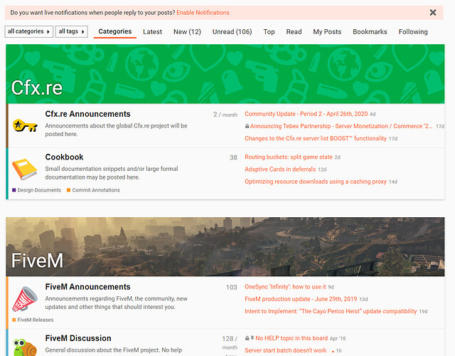

Below is an image of their forums.

I think I explained my issue incorrectly, I am wondering how I add the headers like “Cfx.re” and “FiveM” so I am able to separate my categories to the relevant area as currently everything is placed under one section whereas on the Forums you moderate its under relevant areas.

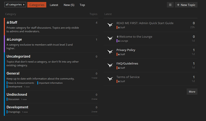

Below is a picture of my Categories page on my forums so you can compare what I mean:
Oh, that is obtained through custom CSS. It hasn’t been publicly posted, but you could perhaps try contacting them to see if they’d be willing to post it. Otherwise, I guess the logic would go as far as setting an image based on whichever class is being used for the category div of the category you wish to put a header above, also adding some padding to the bottom of (in this case, ‘Cookbook’).
